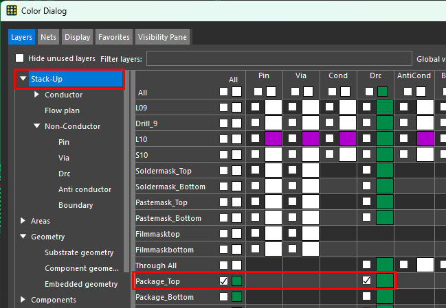

I'm using Cadence Allegro 24.1 and I'm trying to check if the layer "Package_Top" is visible and if not, make it visible.
Neither of these commands work:
if(not(axlIsVisibleLayer("STACK-UP/PACKAGE_TOP")) then
if(not(axlIsVisibleLayer("NON-CONDUCTOR/PACKAGE_TOP")) then
I get this:
*WARNING* Layer does not exist: STACK-UP/PACKAGE_TOP
*WARNING* Layer does not exist: NON-CONDUCTOR/PACKAGE_TOP
If I use just "PACKAGE_TOP", then I get: *WARNING* Layer does not exist: PACKAGE_TOP
Does anyone know the layer pair, or just the layer name that I would use?
Thanks,
Mark
  • MarkGorecki
    MarkGorecki over 1 year ago +1 verified
    Ok, got this figured out. I did a "Show Element" and picked one of the bowties. It showed the class as "DRC ERROR CLASS" and the subclass as "PACKAGE_TOP". I used those names in the code, and it worked…

    Years ago, Cadunce changed the naming convention between Allegro and APD ( IMHO that was stupid ) They finally provided the skill function axlMapClassName() that allows skill code to work with both tools…
    They finally provided the skill function axlMapClassName() that allows skill code to work with both tools...
    Below is an example that should work in both Allegro and APD:
    (axlVisibleLayer strcat(axlMapClassName("PACKAGE") "KEEPOUT/TOP") t)
