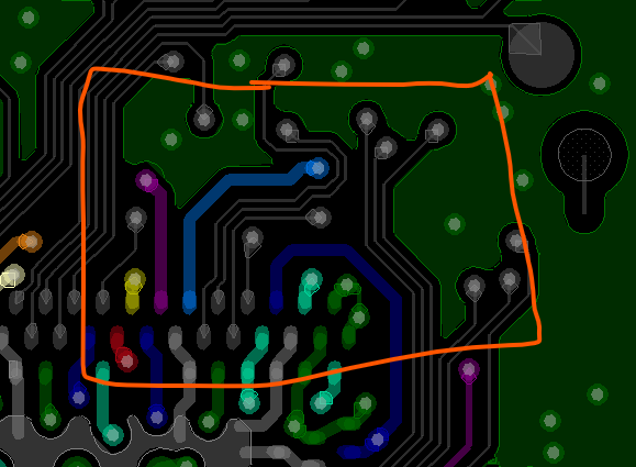

What is the best way or methodology to obtain all voids (lack of metal) on a conductor layer?
I tried to use the following polygon->holes like shown below but it does not get all voids (lack of metal).
shpAbovePoly = car(axlPolyFromDB(shpAbove))
shpAbovePolyHoles = shpAbovePoly->holes
Voids in orange box are desired.
Thanks for help.

  • khuranav007
    0 khuranav007 7 months ago in reply to Hoangkhoipcb
    Thank you for the response.
    But shape->void only appears to work when void is fully 'surrounded' by the shape.
    Meaning, when void (if you draw a void) is enclosed by the shape otherwise shape->void does not identify areas where there is no metal.
    I think I will have to use axlPolyOperation() after getting all metal on each layer.
    Let me know if there's a better way.
    Thanks again.

  • khuranav007
    Hmm thanks.  Still only getting voids completely inside the shape only.
