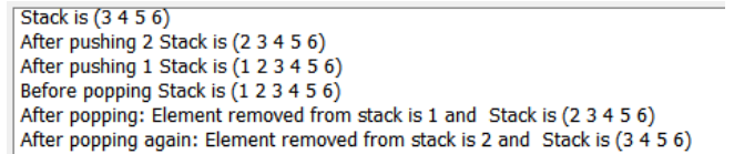

Stack is a popular data structure in programming languages. It is like a real-world stack such as piles of papers, where papers are usually added to the top of the pile and removed from the top. So, in a stack data structure, you can add or remove elements from the top of the stack using the LIFO (Last-In-First-Out) principle.
Stack in Allegro SKILL is a list that works like a stack using APIs/functions pushf and popf.
  • pushf adds an element to the top of the stack, that is, adds the first element to the list.
  • popf removes an element from the top of the stack, that is, the first element of the list.
The code is as shown below:
myStack=list(3 4 5 6)
printf("Stack is %L\n" myStack)
pushf(2 myStack)
printf("After pushing 2 Stack is %L\n" myStack)
pushf(1 myStack)
printf("After pushing 1 Stack is %L\n" myStack)
printf("Before popping Stack is %L\n" myStack)
elem=popf(myStack)
printf("After popping: Element removed from stack is %L and Stack is %L\n" elem myStack)
elem=popf(myStack)
printf("After popping again: Element removed from stack is %L and Stack is %L\n" elem myStack)
The following image shows its output:
