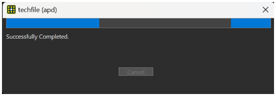

Skill > axlRunBatchDBProgram("techfile" "techfile -$ -r mytechfile.tcfx %s" ?reloadDB t ?logfile "techfile")
  1. Wait while the techfile (apd) runs:
  1. The view of the techfile UI will appear. Scroll to view the summary.
  2. Close the file.
