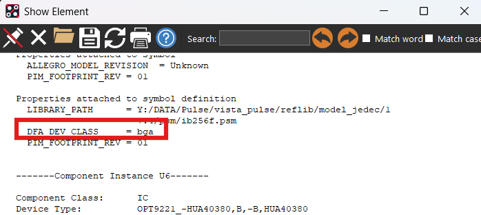

    Hi Hoangkhoipcb
    Thank you for your quick answer! Our BGA property is stored in symbols->DFA_DEV_CLASS.
