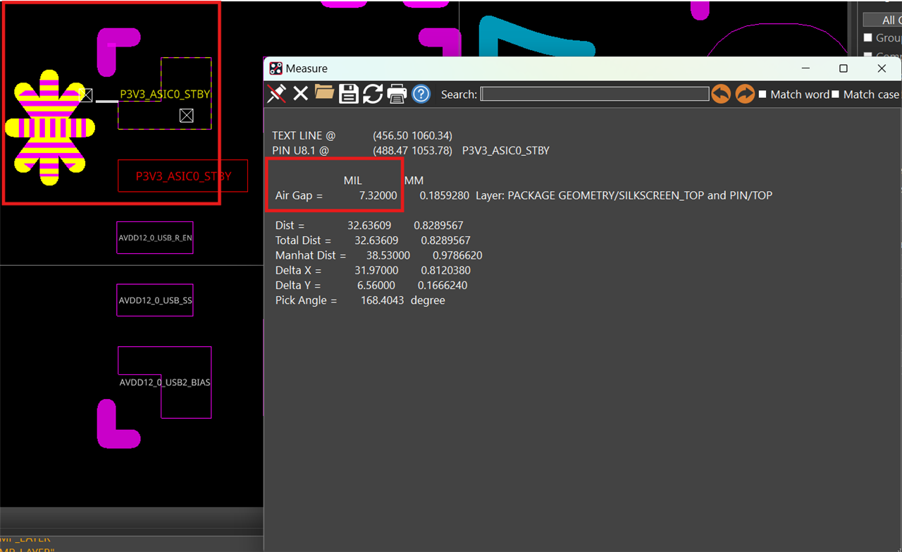

I would like to get the air gap value between the first pin and the pin-1 marker (silkscreen text such as "*" or ">"), as shown below.
I found the API axlAirGap(), but I'm not sure how to implement it.
Could anyone provide an example or some guidance?
Thanks!!

    You can try axlAirGap(pin_dbid mark_dbid nil 'anyLayer) for gap
