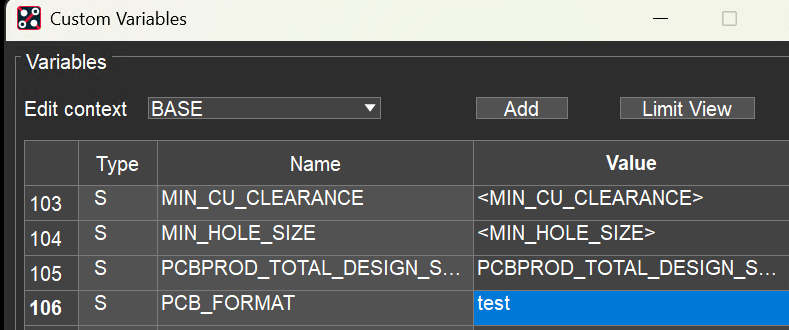

Dear all,
i can use Command tbx customvar update to open the custom variables window.
I can also use axlShell("tbx customvar update") to open the same window but My current Problem is that:
after giving axlShell("tbx customvar update") I do not get the Skill > for the next skill
Skill > axlShell("tbx customvar update")
Reading file "C:/Users/emp8124501/ECAD/projects/251_demo/output/251_demo/physical/customvar.cfg"
Info: Reading custom variables from "C:/Users/emp8124501/ECAD/projects/251_demo/251_demo.cpm"
It missing the Skill > after Info: Reading custom variables from "C:/Users/emp8124501/ECAD/projects/251_demo/251_demo.cpm"
May i ask how could i solve this issue or are there any other skill to use instead of axlShell in allegro x pcb editor such as axlCmd, axlUIWExecuteCommand or axlDBCmd?

    MZ20250602835 2 months ago +1 verified
    Dear All, i found the solution, i used axlShellPost instead of axlShell, such as axlShellPost("tbx customvar update"), there is no problem anymore. Best Regards

    I want to have the skill to update the value of custom variables.
    The commands i post above To update custom variables in Cadence PCB / Allegro using the Toolbox (tbx) utility, open the setup menu, select custom variables, and run the update command to input new values like dates or revisions, then run it again to refresh the drawing.
    I would like to have the same function with using skill instead of commands.

    +1 MZ20250602835 2 months ago
    Dear All,
