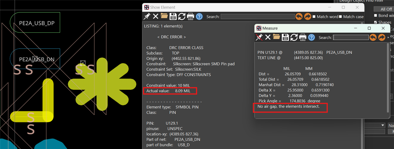

I am trying to calculate the actual distance between a pin and silkscreen text. Although I am using axlAirGap(), the returned value doesn't match the actual value shown in the DRC.
Instead, it returns 'No Air Gap', which is consistent with the Measure tool's result.
Is there a way to accurately calculate this 'Actual Value'?
Thanks!!
  • LF202610219731
    0 LF202610219731 1 day ago
    axlAirGap() does not accurately measure silkscreen text. It often measures text using bounding geometry. DRC instead evaluates the actual rendered text strokes.
    Cadence recommends creating temporary geometry from the font. Then measure that geometry using axlAirGap().
