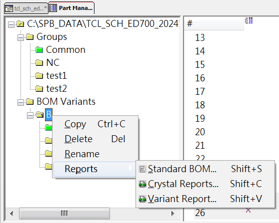

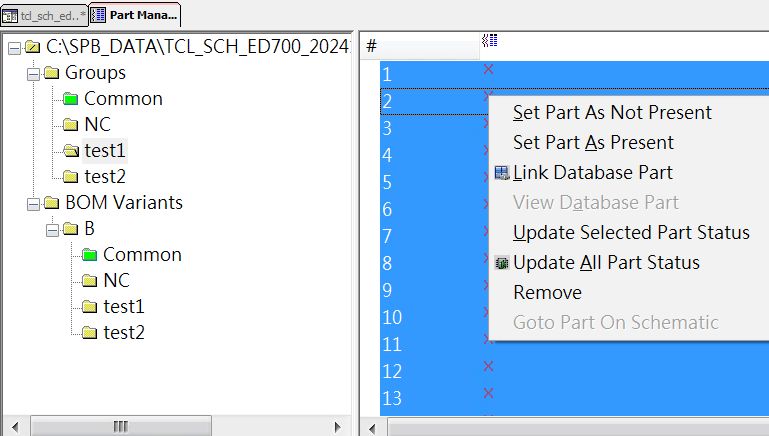

Hi All,
I would like to achieve seperated BOM by the two steps.
1. Keep one group with all its parts set to "Present", and set all parts in the other groups to "Not Present".
2. Use standard BOM to generate report.
The issue I’m facing is that the CPMgtCfg commands SetPartPresent and SetPartNotPresent only work correctly after I manually select any component in the Part Manager. However, I don’t know how to make this process apply on the TCL script.

    Hi All,
    I have been solved my problem about present/not present by follow code.
    if {$lCISInstOcc != "NULL"} {
        set lRefDes [$lCISInstOcc GetPartRefDes]
        set lRefDes [$lRefDes GetRefDes]
        set lRefDes [DboTclHelper_sMakeCString $lRefDes]
        set lRefDesStr [DboTclHelper_sGetConstCharPtr $lRefDes]
        # puts "Part Reference: $lRefDesStr"
        SelectGroup Groups $grpName $lRefDesStr; SetPartNotPresent;
    However, I found this methed cannot generate BOM for each group by MenuCommand in advance.
    standard_bill_of_materials $root $enabledGrp
    Menu "Reports::CIS Bill of Materials::Standard" | DialogBox "OK" "${root}/standard_bom_${enabledGrp}.xml"
    MenuCommand 57927 | MessageBox "YES" "Save changes to C:/Cadence/SPB_17.2" | FileDialog "OK" "C:/SPB_Data/${enabledGrp}.BOM" 1
    Finally, i reference the sample code "C:\Cadence\SPB_17.2\tools\capture\tclscripts\capCustomSamples\capGenerateBOM.tcl" to complete my job.Smile
