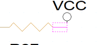

I have a question regarding TCL in OrCAD Capture.
When a pin is connected to a wire, and that wire is connected to GND, I can use DboWire NewGlobalsIter() to get the DboWireGlobalsIter, then use DboWireGlobalsIter NextGlobal() to get the connected DboGlobal (GND).
However, if the pin is directly connected to GND, is there a way to use DboPortInst to find the connected DboGlobal?
So far, I haven't found any way to use NewGlobalsIter() on DboPortInst.
Has anyone encountered a similar issue?

    YW202505149337
    Are you talking about below scenario.
    If yes, please selected the pin and type below command:
    [GetSelectedObjects] GetNet [DboState]
    [GetSelectedObjects] GetWire [DboState]
    You can directly get pin dbid and pass above in place of [GetSelectedObjects] to work for all pins.
