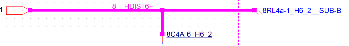

Im trying to update wire alias name as schematic and flat netname i tired in two different ways, but it remains the same. Can anyone please help me to find the solution.
Program:
SetOptionBool Journaling True

Output:
8__HDIST6F
8RL4A-1_H6_2__SUB-B
8RL4a-1_H6_2__SUB-B
I want to update this name in netname also in flat netname.

    Hi kartikey,
    While you’re iterating over the properties of the schematic net, I noticed that you’re trying to update the “Net Name” property. Instead, you should be updating the “Name” property of the net object.
    I’ve modified your code accordingly below to reflect this change:

    HI, Thanks for the reply...
    Still remains the same not updated.
