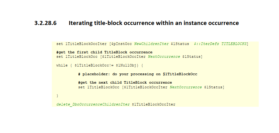

So I used this code to get all the Occurrences of the title blocks .
but is the getting and setting of properties the same as a regular title block ?
set lname [DboTclHelper_sMakeCString]
set lValue [DboTclHelper_sMakeCString]
$lTitleBlockOcc GetName $lname
$lTitleBlockOcc GetValueString $lValue
set lState [$lTitleBlockOccSetValueString $lname ]

    Hi Mhawley1 ,
    When iterating through the title block occurrences, note that $lTitleBlockOcc returns a DboOccurrence object. Therefore, you cannot directly use methods like GetValueString, which belong to the DboDisplayProp class.
    To retrieve a property such as Name, Rev, etc., you can use:
    set lProp [DboTclHelper_sMakeCString "Name"]
    $lTitleBlockOcc GetEffectivePropStringValue $lProp $lname
    Similarly, you can retrieve other property values using their respective names.
    To modify a property, use the SetEffectivePropStringValue method in the same way.
    Hope this helps!

    +1 Mhawley1 over 1 year ago in reply to TechnoBobby
    Yep that allowed me to get the rev's of the title block . THANK YOU !!!!
    proc iterate_title_block {pInstOcc} {
    global lStatus
    set lTitleBlockOccIter [$pInstOcc NewChildrenIter $lStatus $::IterDefs_TITLEBLOCKS]
    #get the first child TitleBlock occurrence
    set lTitleBlockOcc [$lTitleBlockOccIter NextOccurrence $lStatus]
    set lNullObj NULL
    while { $lTitleBlockOcc!= $lNullObj} {
    # placeholder: do your processing on $lTitleBlockOcc
    puts $lTitleBlockOcc
    puts " right before rev"
    #can not run
    set lProp [DboTclHelper_sMakeCString "RevCode"]
    puts [DboTclHelper_sGetConstCharPtr $lname]
    puts $lname
    #get the next child TitleBlock occurrence
    # puts $lTitleBlockOcc
    delete_DboOccurrenceChildrenIter $lTitleBlockOccIter
