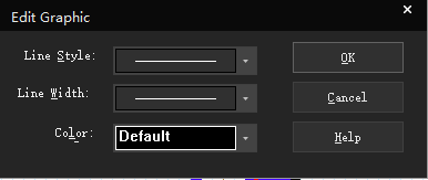

I want to use TCL to implement a Menu "Place::Line". It should allow me to use my selected Line Style, Line Width, and Color to freely draw lines, rectangles, and annotations with the mouse. However, I currently have no idea how to implement this. Could you please suggest some good methods?

    Please see the sample scrip how I am drawing a line from the lst click of the mouse and changing the size and color.
    roc capEnabler {} {
    return 1
    proc capDrawline {} {
    set lMouseClick [GetLastMouseClickPointOnPage]
    set lX2 [expr [lindex $lMouseClick 0] + 30.00]
    set lY2 [lindex $lMouseClick 1]
    # puts $lMouseClick
    PlaceLine [lindex $lMouseClick 0] [lindex $lMouseClick 1] $lX2 $lY2
    SetLineWidth 2
    SetColor 8
    RegisterAction "DrawLine" "capEnabler" "Ctrl+R" "capDrawline" "Schematic"
    Similar you can do for other shapes.
    Hope it will help to proceed further.

    Thank you. I understand the usage of this code, but I want to set the style first. Then, I can control the head and tail with the mouse as in the standard function on the interface. Right-click "done" to cancel. Is there any way to do this?
