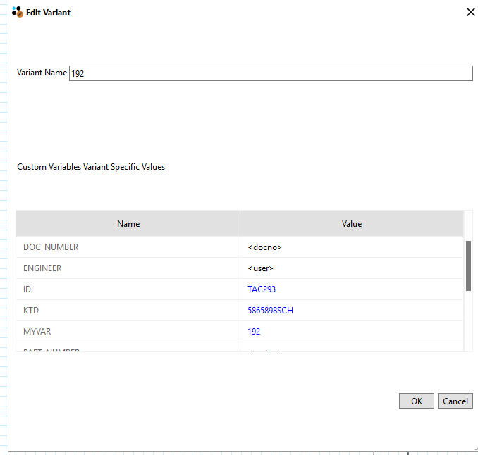

TCL Script System Capture get ALL Custom Var from Project and all from all Variants
PIPE
PIPE over 1 year ago
Sorry, i have search a lot but found nothing.
I must make some folders and my idea is to export via tcl all this information and with a exernal tool i read out this info and generate for every variant and master a sperate folder to but the bom etc inside.
Thanks for your help.
Peter

  • PIPE
    0 PIPE over 1 year ago in reply to CadAP
    hello,
    unfortinatly this works only for the customvar in the root not for variants
    Tcl> source c:/cadence/tcl/d.tcl
    GE
    <partno>
    <docno>
    <v>
    <date>
    <user>
    <title>
    BASE
    TAC290
    5865895SCH
    7
    P9
    7
    H
    in my variant i have change some customvar with the varianteditor

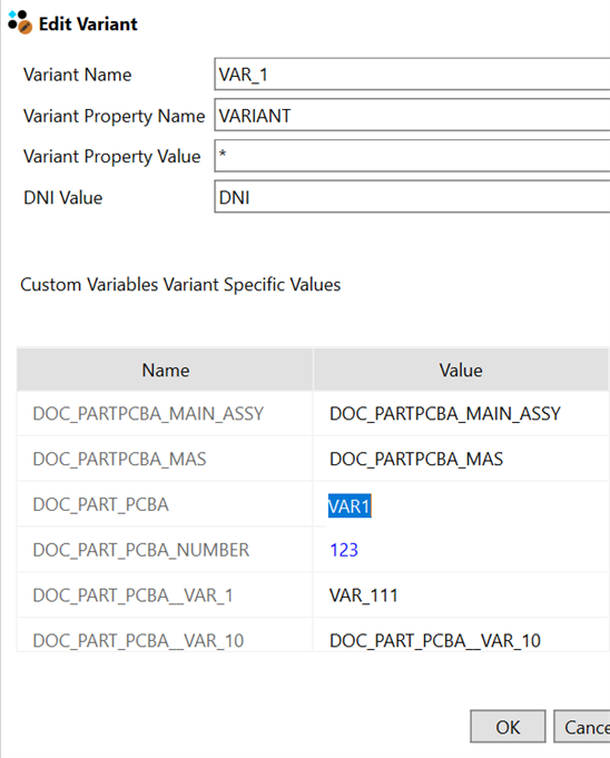

  • MZ20250602835
    0 MZ20250602835 8 months ago in reply to CadAP
    Dear CadAP,
    may i ask how could i make a TCL/script in order to get the Custom variables variant specific Values for specific row(For example row3 DOC_PART_PCBA) and then give/transfer this value to a customer variables?
    Many thanks
    Moyan
  • PIPE
    0 PIPE 8 months ago in reply to MZ20250602835
    I unfortunately couldn't find a way  to read or write the changed customvariables from the variant editor.
    The only way was to export the variant.dat and read everything from it.
    I solved this, however, with an external tool I wrote, because I needed this information externally anyway.
    if you find a tcl solution, please post it.
    -Peter
  • CadAP
    0 CadAP 7 months ago in reply to PIPE
    PIPE MZ20250602835
    Please use below code to get the custom variable name and value in list:
    proc getCustomVar {} {
    # puts "entering check mode"
    set toolVar [lindex [cps::getAppVersion] 0]
    set lDesigName [sch::dbGetRootDesignName]
    cpb::extractFile "worklib/$lDesigName/variant/variant.dat" {variant.dat}
    set filename "variant.dat"
    set pattern "CV_"
    set fp [open $filename r]
    set functiontest {}
    while {[gets $fp line] >= 0} {
    if {[string match -nocase "*$pattern*" $line]} {
    # puts $line
    lappend functiontest $line
    close $fp
    puts $functiontest
    if {[file exists $filename ] == 1} {
    file delete $filename
    getCustomVar
    You have two variants, V1 and V2, and the expected result is as below:
    **Expected Result:**
    { CV_V1 = 'TEST_V1=1236|TEST_V2=T_v1' ;} { CV_V2 = 'TEST_V1=T1|TEST_V2=T2' ;}
    Please do let me know your feedback.
