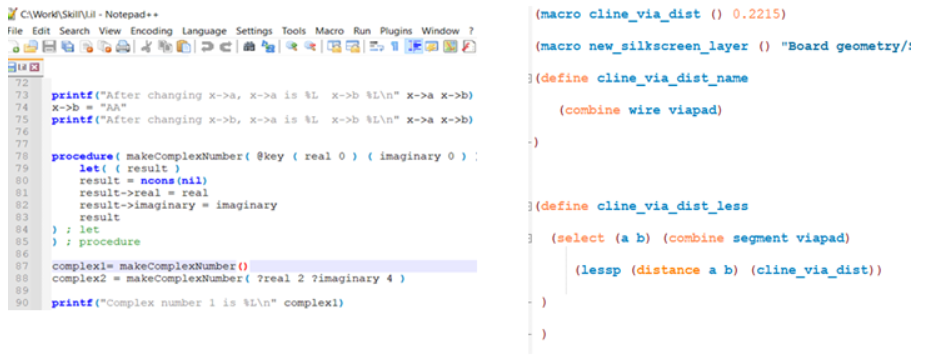

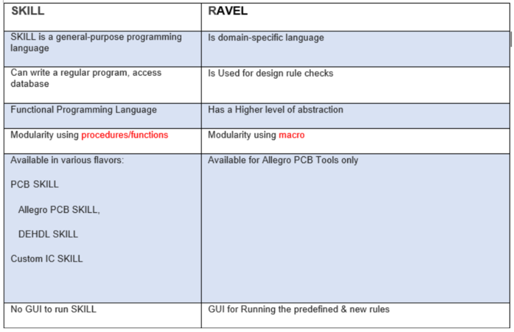

SKILL provides a safe, high-level programming environment that automatically handles many traditional system programming operations, such as memory management. SKILL programs can be immediately executed in the Cadence environment. The SKILL programming language lets you customize and extend your design environment. SKILL is ideal for rapid prototyping.
RAVEL is a language to implement design rules for PCB and Packaging tools. It builds on a relational view of the design data.
The below table highlights the difference between SKILL and RAVEL:
Following image shows the code of SKILL and RAVEL.
The article, Syntax highlighting for SKILL and RAVEL in Notepad++ text editor, explains in more detail.

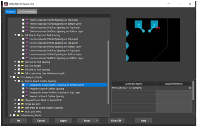

DFM Ravel Rules GUI for PCB is shown below. BoardSurfers: Training Insights: How to Run a RAVEL Rule from the GUI explains in detail how to run rules from the GUI.
