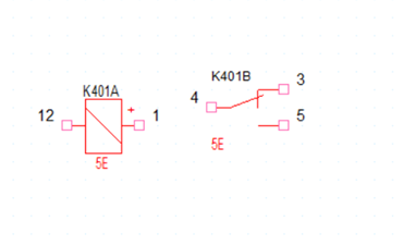

So what I do is the following:
I place a multi part component, so let's say K401A and K401B in my schematic
Looking at the Part Manager I see that K401 (Designator A) is added to the common Group. --> so far so good --> the Component is Mounted
then I add it to a Variant group and set it to "Not present" --> so far so good --> the Component is Unmounted
Then I go ahead in the schematic, select the Part K401B and use the right Mouse button to add it to a Variant  Group --> WOW, why I am allowed to do this, the "Physical Part" should already been added before.
Now,back in Part Manager, I still see that the Part K401 (Designator A) is  set to "Not present"... but... when we now run the tcl code to get the Variant BOM, I see both part entries, K401A and K401B, both in the same group, but one as present and the other one as not present --> why is it be possible to have such a situation. I have ONE physical Component which is a MultiPart package (or fractured Symbol). I should be be able to assign the individual parts to different groups. If I add one part to a group, then it must be valid for all the parts (once again, we are dealing with one physical Component).

So what I am missing here? What is the usecase which makes this required/useful?
in addition, I have absolutely no possibility to visualize this issue nor to correct it. I would need to know what is going wrong somehow and then manually remove K401B through the Command action in the schematic.
How can we identify and deal with this situation and make sure, that the BOM is created on the physical components and not the instantiated parts. Not clear to me which tcl functions to use for this.
I though about considering the Reference Designator/Designator, but this would also not be really working, as I can manually assign a RefDes and therefore they could be the same but are indeed different physical components (--> yes, this is a design error, but we would need to deal with it somehow). So I would need to have a possibility to identify if a component is mounted or not across all available parts of this component (essentially it seems that if one part is set to not present, then the component is not present)
