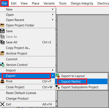

Many a time, while exporting the design to the board, you might want to control the transfer of user-defined properties, ignore fixed property, overwrite current constraints, and so on.
System Capture supports multiple such options.
Option 1
Using File > Export to Layout, you can export the schematic to generate or update a board file. Also, you can choose the required output file based on the desired flow like PCB Editor, PCB SI, and Package Designer.
Option 2
There is a way to generate only the physical netlist of the design.
You can use File > Export Netlist to create the netlist in the packaged folder of the project directory.
