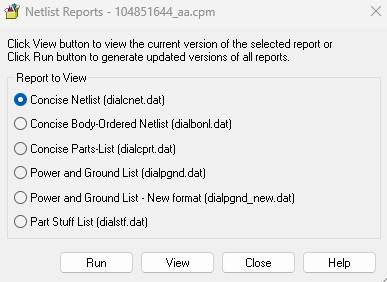

As shown in below screenshot, in 17.4 we had Concise Netlist (dialcnet.dat) export option but could not find any option to export netlist in (.dat) format. Is there any option in Cadena System capture 22.1/23.1 to export concise Netlist
(dialcnet.dat)?

    Hi Arsalan1001 , Try the below command in the Allegro system capture command console: exec dsreportgen -ui and similar gui will appear. Try and let me know how it goes.

    Thank you for your response. Command "exec dsreportgen -ui" worked and I can generate concise netlist report.
