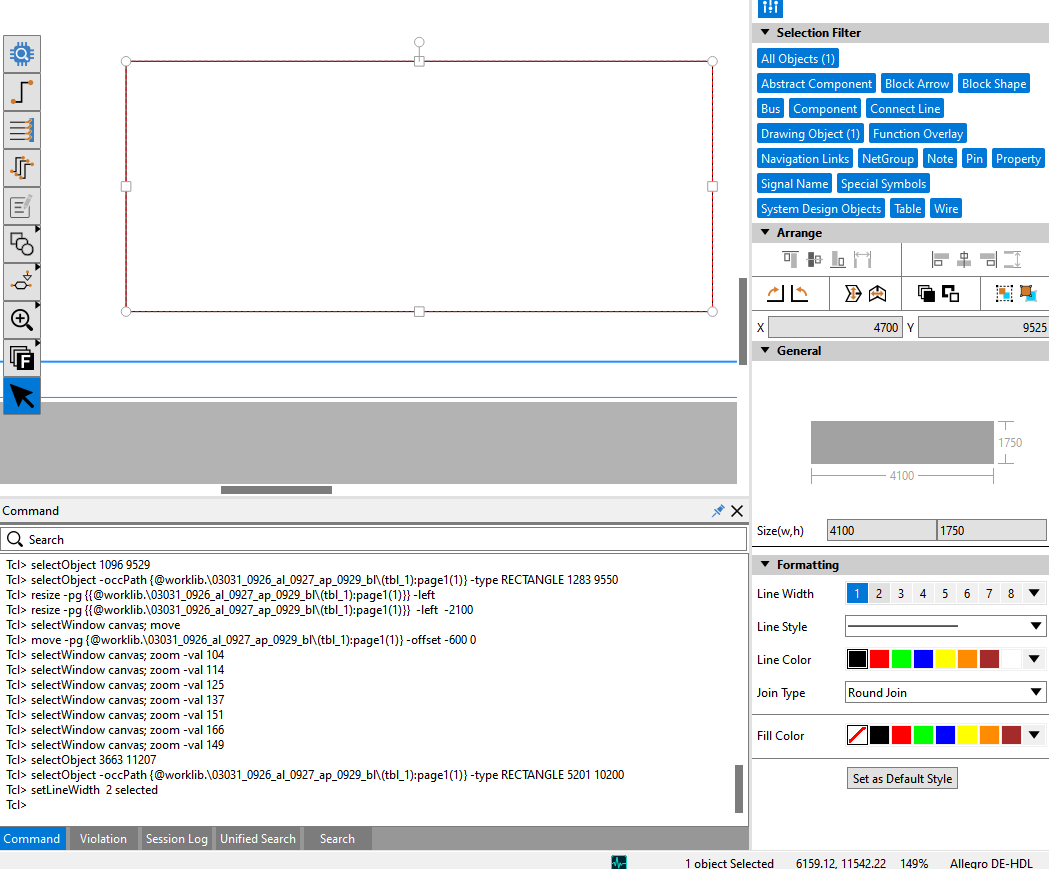

I cannot format Drawing Objects. The only parameter that responds is Fill Color. Line Width, Line Style, Line Color do not respond to changes.
For example in this image, I select the rectangle and click on 2 in the Line Width. The TCL command is generated but the Line Width stays at 1.
Is this a known issue?

    Tried on 24.1 S005 and its working as expected. Line width, fill color and line style everything is working as expected for me. Try to restart Syscap session and then try to change line width to 8 and…

    Also, disable ''Enable wire segment styling" from Edit > Preferences > Wiring/ports and then test it.
    Try to restart Syscap session and then try to change line width to 8 and then see if graphical changes are observed or not.
