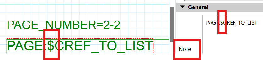

Dear All,
after Migrating DE-HDL Designs to Allegro X System Capture i got some notes which contain the $ in different positions and different pages.
I can find these notes via the tcl command as below:
find -scope "Entire Design" -types "note" {$}
but may i ask how could i only the notes which contain the $ select and then delete? The notes which don't have the $ still stay in the schema.
Many thanks
Best Regards
Moyan
