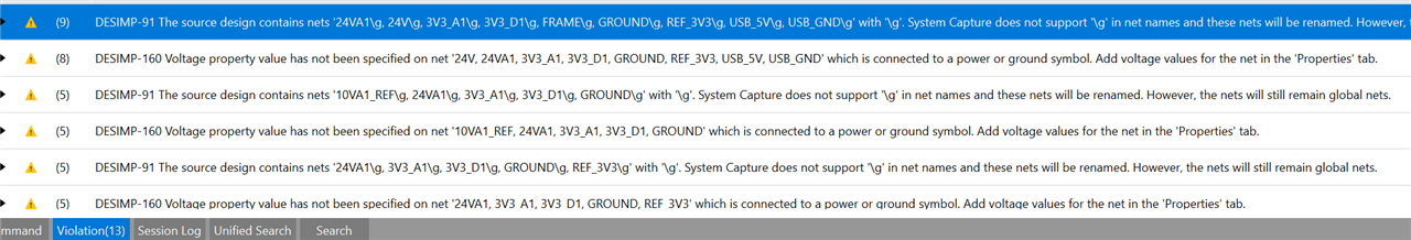

Dear All,
after Migrating DE-HDL Designs to Allegro X System Capture i usually get some warnings in violation window such as :
may i ask if it is possible to waive these Warnings with TCl Command or other settings under START_CANVAS instead of waive the violations manuell after each import?
Many thanks and Best Regards
Moyan

    CadAP 9 months ago in reply to MZ20250602835 +1 verified
    MZ20250602835 Try below command: cps::clearViolationMessage messageType messageNumber For example, for clearing Message is DESIMP-91 cps::clearViolationMessage "DESIMP" "91"

    Dear CadAP,
    many thanks again for your reply. I would like to define an action which content the TCL Commands to waive some general warnings after Migrating DE-HDL Designs to Allegro X System Capture automatically such as "System Capture does not support \g in net names and these nets will be renamed. However, the nets will still remain Global nets", "Voltage property value has not been specified on net `24V which is connected to a power or ground symbol. Add voltage values for the net in the `Properties` tab", "Color applied to custom texts on page border in the source design will be ignored because the color does not match the page border symbol color. The page border symbol color will be applied to the custom text" and so on instead of click the waive Button to waive them manually within Allegro X25.1(for 23.1 System Capture there is currently no such Waive Button as 25.1 in Violation Window available).

  • MZ20250602835
    0 MZ20250602835 9 months ago in reply to CadAP
    Dear CadAP,
    many many thanks, this is what i need.

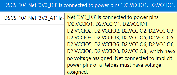

  • MZ20250602835
    Dear CadAP,
    may i ask you further question and i got DSCS-104 in violation tab. Is it possible to use command to clear this message also?
    Many thanks and best regards
    Moyan
  • CadAP
    0 CadAP 9 months ago in reply to MZ20250602835
    MZ20250602835
    Try below command:
    cps::clearViolationMessage "DSCS" "104"
  • MZ20250602835
    Dear CadAP,
    many thanks for your reply. I already tried this command cps::clearViolationMessage "DSCS" "104" and after given this command i got the value 0.
    I tried to follow the warning Message to add a value and the warning is away. I assume that this kind of warning can't be waived without assigning a voltage value.
