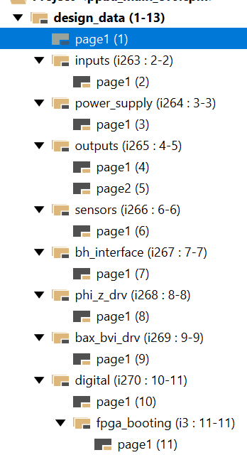

Dear ALL,

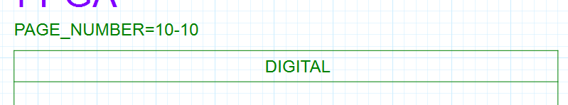

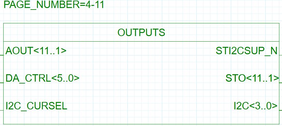

with the script within Displaying start page number for hierarchical blocks in Allegro X System Capture i can get the Page number for the blocks by Simple Hierarchy. But if i have a multiple levels of hierarchy as below i can't get the right number of blocks on page1(1). I got the wrong number for the outputs block and digital block.

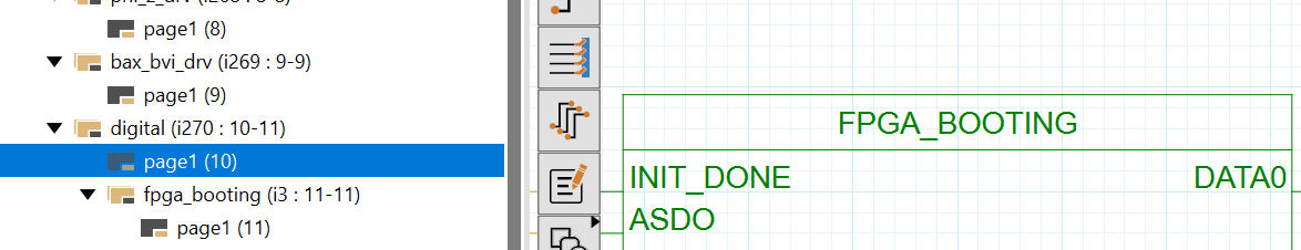

Within Page10  there is no page number for fpga_booting block.
May i ask how could i amend the script to get the right number for the block?
Many thanks
Best Regards
Moyan

    Could you please advise me which new scripts should i used to get the Page Number of the sub block for example the sub block fpga_booting in block digital?
    Is it necessary to also add codes to check if the design is simple hierarchy or multi hierarchy?
