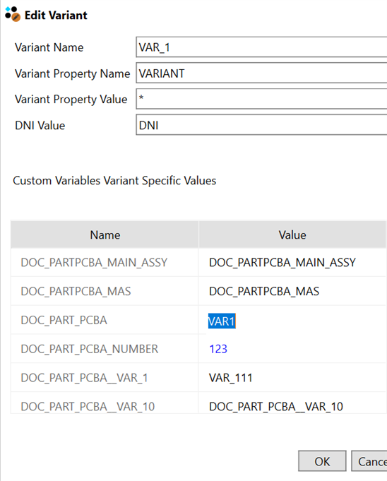

Dear all,
may i ask how could i make a TCL/script in order to get the Custom variables variant specific Values for specific row(For example row3 DOC_PART_PCBA) and then give/transfer this value to a customer variables?
Many thanks

    MZ20250602835
    Please try the script below, as it will update the custom variable value by reading from the variant.
    For the purpose of this example, I've taken the first value of the variable from Variant in case of multiple variants.

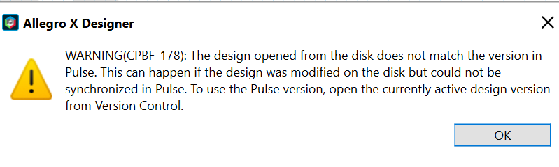

    i realised that the values will be updated after reopen the design.
    But after reopen i get the warning because of the Pulse.
    May i ask if is it possible to avoid this warning after reopen? or update the custom variables value without reopening the design?

  • CadAP
    0 CadAP 7 months ago in reply to MZ20250602835
    MZ20250602835
    Retrieve the list of variants from the design using the function cps::getVariantNames, which returns the variant names in order, and store this list in a variable.
    Iterate to the foreach loop defined in the above code and retrieve the variable value 'data'.  Parse the variable by removing the prefix "CV_" and then match the resulting variant name against the list from above in order to obtain the corresponding property value.
    This will help you to achieve you requirement.
