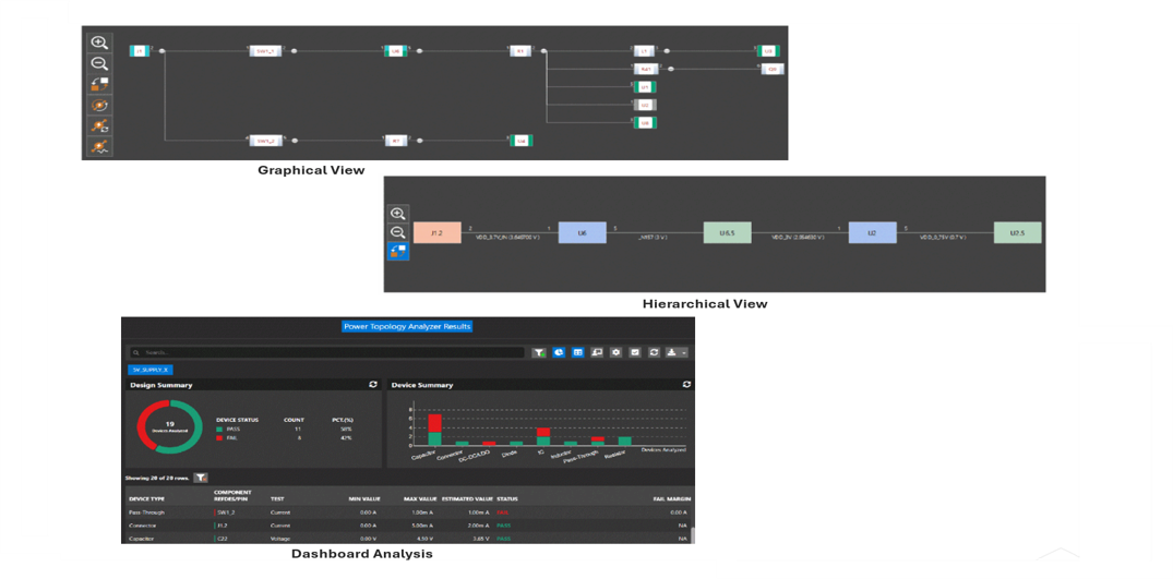

Power Topology Analysis in Allegro X System Capture offers early validation of the Power Distribution Network (PDN) directly from schematic data. It enables designers to visualize power flow, verify power distribution, and identify potential issues before moving further into the design cycle.
The generated topology includes:
  • Power net names and voltage rails
  • DC sources and regulators
  • Pass-through components
  • Decoupling capacitors
  • Power sinks and consuming devices
  • Source-to-sink power flow relationships.

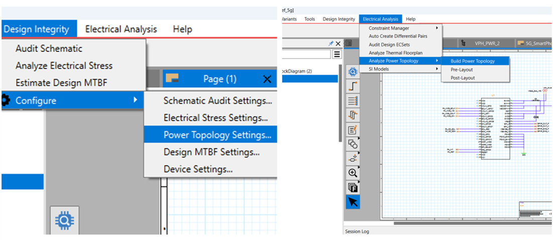

Quick Setup
  1. Open Design Integrity → Configure → Power Topology Settings

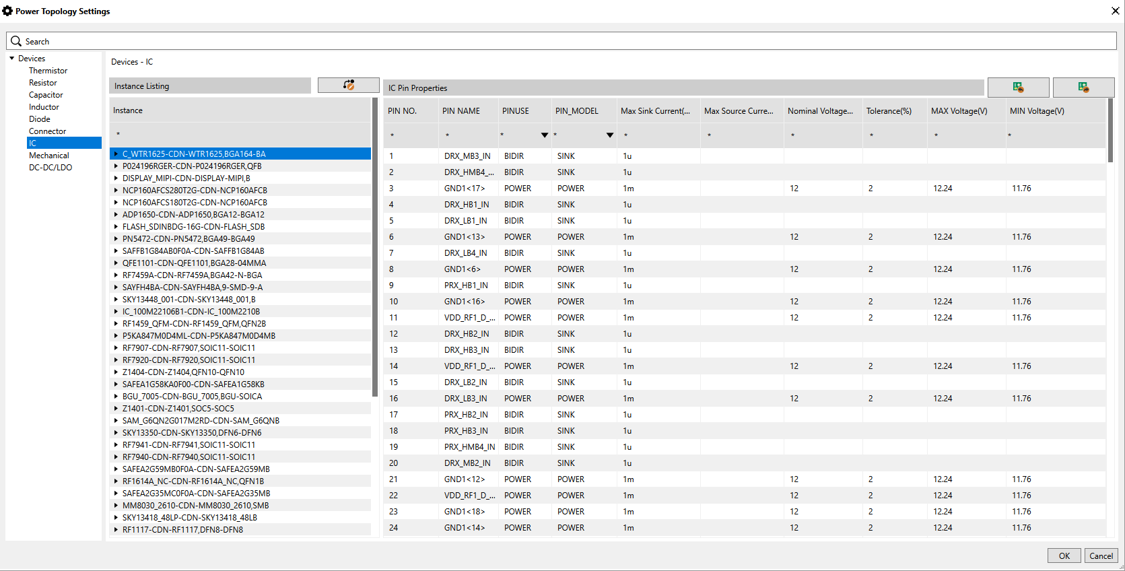

    2. Define DC Sources
    3. Configure DC-DC/LDO devices
    4. Identify Pass-Through components
    5. Define Power Sink pins
    6. Configure required source and sink parameters for the pins.
Once configured, System Capture has sufficient information to build the PDN and understand power flow throughout the design.
Running the Analysis
Run Electrical Analysis → Analyze Power Topology.
You can review results through Graphical View, Hierarchical View, or Dashboard View.  The graphical view provides a visual representation of power flow through the design, while the dashboard helps review analysis results and identify potential issues.
Prerequisites
To perform Power Topology Analysis effectively, it's essential to specify power sources, sink pins, and DC-DC/LDO devices along with detailed voltage and current data. This ensures the PDN can be constructed and examined accurately.
