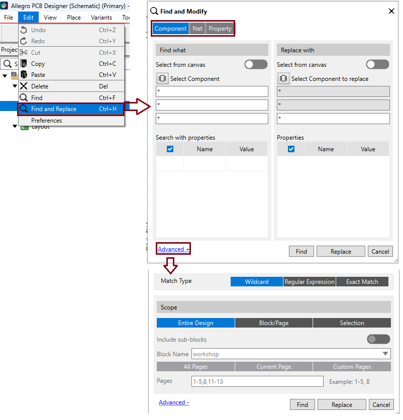

Design changes are a normal part of schematic development, whether driven by evolving requirements, component availability, or ECOs.
Allegro X System Capture simplifies these updates with the Find and Replace feature (Edit → Find and Replace). By selecting Advanced, you can define the scope of changes as Entire Design, Block/Page, or Selection.
With a few clicks, you can:
  • Replace components throughout a project
  • Rename net names globally
  • Update properties in bulk
This capability helps reduce manual effort, improves design consistency, and accelerates design updates across large projects.
