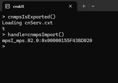

I use Allegro Design Entry HDL 23.1.
With project opened and DE HDL running, in console window I enter "cnskill -i -nongraph"
Then, SKILL window opens with ">" sign.
Entering "cnmpsIsExported()", I get "t" - i.e. session is ready to be imported, right?
But, when i enter "handle=cnmpsImport()", it outputs message about timeout expired while contacting server.
What may be wrong?
Thanks

  • rg13
    0 rg13 over 1 year ago
    In DEHDL console window, I run the command:
    system (cnskill -i -nongraph)
    It opens skill window and then I run the command which you mentioned, following is the output:
    I am using 23.1 S010.
  • Igor S
    +1 Igor S over 1 year ago in reply to rg13
    Thanks!
    My problem was because curse suggests something another.
    In pdf of lab, they suggest to enter "system", and THEN in system window enter "cnskill -i -nongraph"
    In this case, the SKILL window opens, and "cnmpsIsExported()" returns "t" - but cnmpsImport() stuck till timeout
     mpsImport, timeout elapsed while attempting server hand-shake mpsImport, timeout elapsed while attempting server hand-shake mpsImport, timeout elapsed while attempting server hand-shakempsImport, hand-shake timed out
    nil
    Thanks again!
