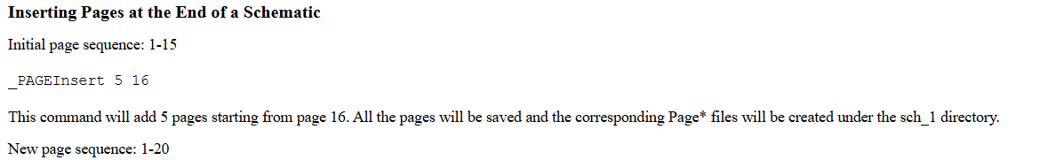

I use console command "_PAGEInsert -noconfirm" in order to insert new page from SKILL script.
And I dint want any user confirmation, so I use "noconfirm" key.
But, upon insertion, it pops up the completion message with OK button, and stuck till pressing it or ENTER. So, despite "noconfirm" key - the iteraction with user still needed.
How can I suppress this user input request?
Thanks

    I tried with following command in DEHDL's console window:
    _PAGEInsert 1 2 -nosave -noconfirm
    It works without any issue and does not ask for any confirmation and no pop up comes-up on display.
    Screenshot from manual:
    For your reference here is the link of manual for your from ASK portal:
    Allegro Design Entry HDL Reference Guide -- Console Command Reference

    It does not work as you describe.
    After page insertion, it issues completion message and waiting for pressing OK
