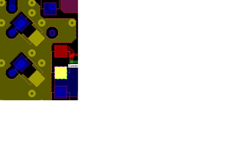

Good Day to All ! What is the advantage of placing compnent at 45 degere & how this will effect on stencil (find the attched image , here it possible to place straight ,but plced at 45 degere.) Regards,Griish kumar

    Looks good, but as far as I remember the IPC 2221 standard does not really suggest this kind of component placement.
    "Components should be mounted parallel to the edges of the printed board."
    IPC-2221 Generic Standard on Printed Board Design,  section 8.1.3 Orientation
