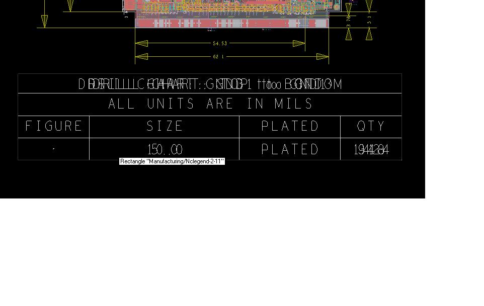

Respected Sir, When we generate the drill chart for board file, that chart overlapping. Board contains blind and burried vias. I have attached an attachment which shows the drill chart with overlapped text inside it. I am waiting to your reply.

    Each of the drill charts are placed on a different manufacturing subclass. So you would need a seperate drawing for each. You can move each one individually after they have been created, if you wish.

     Until the origins for the charts have been established they will lay on top of each other.  Select "Move->Groups" and then click on the chart-- it will move as a whole unit.  You can place it where you wish.  Do that for each one.

    Thanks for suggestion .........................problem solved .

    One additional thing to keep in mind. Once you move the chart (using Move/Group selection) they will regenerate at those location the next time the table is generated (pretty handy).
