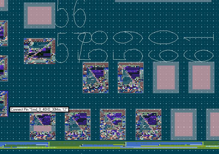

When I mouse over elements, it gives me this weird coloring (instead of highlighting). Why?
  • KeithP
    KeithP over 17 years ago
    You may have an OPENGL issue with your graphics card. Try switching the OPENGL off to see if it makes a difference...
    Setup -> User Preference and check the Opengl - disable_opengl value box. You will need to restart Allegro.
    Cheers,
    Keith
