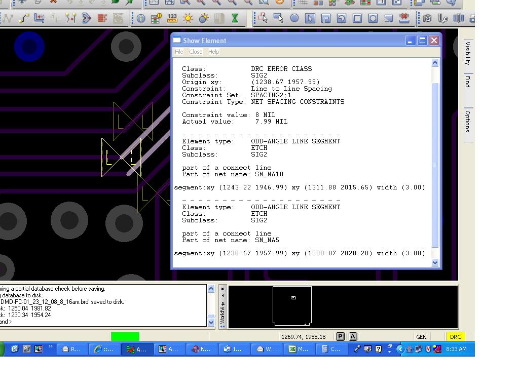

I am facing accuracy problem when i converted board file from mils (2 decimal place) to mm (4 decimal place ) again converted back to mils its showing 0.01mils less showing drc through out the board. & when I measure the pitch b/t pin (unit mils) it is incrasing by 0.01mils .REgards,GIirish

    Do not convert boards between metric and imperial units. Unlike some CAD tools where the database units are just a display, Allegro actually converts and as a result you get rounding of all features including padstacks, pitches, line widths etc. This can turn the database into a right mess. Always set up the database in the unit of choice and stick to it, never change it.
    Cheers,
    Keith

    We have done this type of changes almost in every board but never facing this problem. I think the prblem is that you start with accuracy of 2 decimal places and jump to 4. We always use 4 decimal accuracy sometimes it create problem having 4 decimal places accyracy with mils but it can be solve by using 4 decimal accuracy with mm and than you move to mils and increase the accuracy to 4. If it works please let me know.
