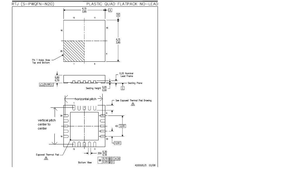

    Hi , I also have some clarification regarding library creation. usually we will multiply by 2mm for the length of the pad & 1.2mm for the width( for eg if pin length :0.75mm & pin width :0.5mm then land pattern size will be 0.75x2=1.5 & Pin width =0.5x1.2=0.6mm using this data for finding vertical pitch & horizantal pitch which pin length we need to consider before multiplication or after multplication )& for very fine pitch devices & QFN packages how we can take care if we multiply by 2 & 1.2 pin will touch each other (we are facing more problem with QFN package during assembly & testing since pads will be burried under the package ) Regards,girish

    If the corner pads are touching each other,then you trim only the corner pads with 45 deg by maintaing 6 to 8 mils air gap.
