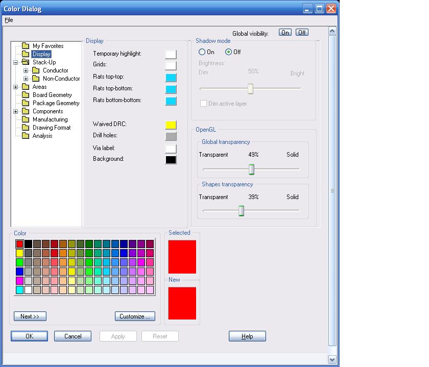

I'm new with Allegro (16.2), I have previously usedused Orcad layout.
I could not find the menu to change the ratsnet color. Does it exist?
This usefull while routing, to identify the GND, Power or special nets.
Thanks for any suggestion.
  • redwire
    redwire over 17 years ago
     In the Display->Color menu.  See attached screenshot.  You have 3 kinds of rats to color in 16.2.  Previously just 1 kind.
  • steve
    steve over 17 years ago
    In 16.2 You can color nets based on net names. Under Display - Color Visibility - Stackup there is a radio button for layers and nets. If you switch to nets you can color items based on net names.

    Hi Redwire,
    Thanks a lot. It works.
    Also excellent the second reply. mentioning the radio buttons for NETS. This menu allows to change the color by net name.
