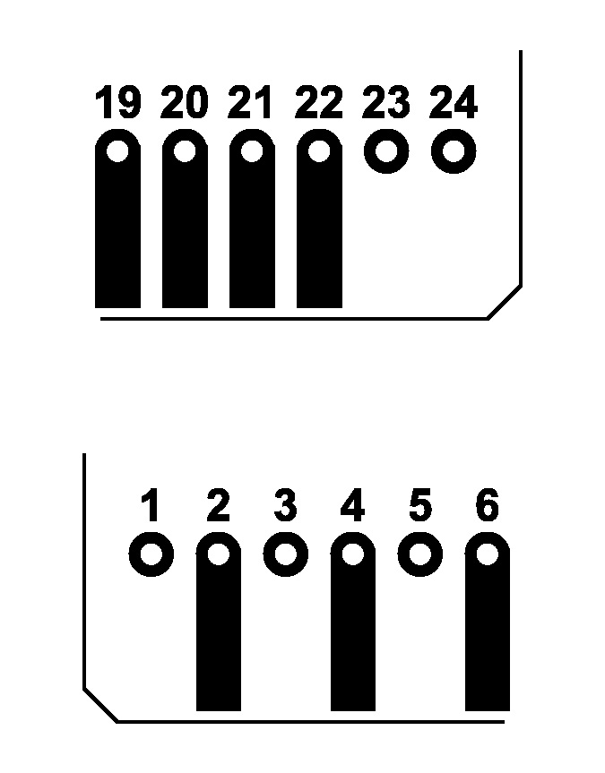

Before release 16.0, we used a null padstack. The null padstack was used as a placeholder padstack on a surface-mount connector in which certain pins are not used , for keying purposes. In some other cases different pins were not used and/or a different number of pins were not used. They were all alternate symbols for the same part number component. Alternate symbols for the same default symbols must have the same number of pins. For example, on a 24-pin connector, pins 23 & 24 may not be used, where on another alternate, pins 1,3 & 5 may not be used. Before, I was able to define the null padstack by creating a definition on a non-electrical layer that was not used, for example, FILMMASK_TOP. There, no DRC's would appear on any electrical layers. This worked well when producing gerber files and ipc356(not ipc356A) netlist that were checked in Valor. IPC356A is not translatable in Valor.
Now, in release 16.0 and above, padstacks are now required to have some kind of definition on an electrical layer. If I define anything on a electrical layer, even as a circle shape with no dimension, DRC’s will occur as in its spot to a plane or trace or via.
Cadence responded this to my situation: The electrical symbol would has to match the physical. That being said the physical has 22 pins, either pins 1/3 missing or 23/24.You would then need the elec. to have the same pins missing. If you want the ipc netlist to come out - and meet the spec - then you will need several sym sets. I don't believe there is a 'one size fits all' answer here.
Has anybody used a padstack in the same situation that I described in rel 16.0 and above? If so, how did you define the padstack? Was there  any DRC's as a result? Any suggestions would be much appreciated.

    I had similar situation in the past but I have always had a pad on one of the electrical layers.  I do have a suggestion which may help.  Why not just use a smaller padstack to achieve the same result for the pins which are not present, something like a small smt pad or pad with a drill which can have the pin number associated to it.  I attached an example of what I am talking about in an edge connector situation.  Now this may not work with your particular surface mount connector but may be a good alternative for you.
    Hope this helps,
    Mike Catrambone
