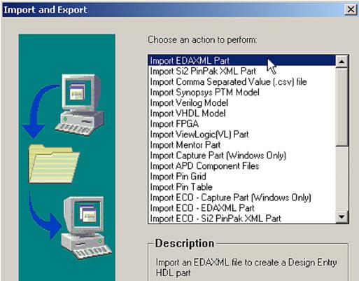

Is it possible to create a schematic symbol from a vhdl entity or verilog module?

    In Part Developer you have the ability to import and export several different formats but it requires an Allegro PCB Librarian Expert License.  If you do have the license you will have access to the Import/Export wizard via the File menu. (File > Import and Export) where you can import a VHDL and Verilog Model as a starting point for a schematic symbol.  I think this is what you are looking for.
    Hope this helps,
    Mike Catrambone
