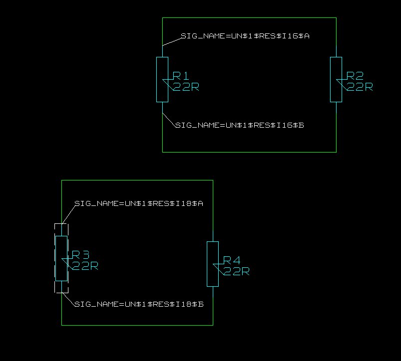

    I'm using DEHDL 16.2 and I've tried to replicate this problem. See attached screenshot.
    In this example I placed and connected R1 and R2 and could then view the SIG_NAMEs UN$1$RES$I16$A/B
    I then replicated R1 (using copy-all) as R3 and R4, connected R3 and R4 together and could see the SIG_NAMEs UN$1$RES$I18$A/B
    It appears that whilst the SIG_NAME property is present, it has been assigned a new instance name when the component has been copied.
    Note, we are using our own resistor library rather than the standard Cadence library.
    Let me know if you'd like me to try anything else out.
    Cheers
    Bryn

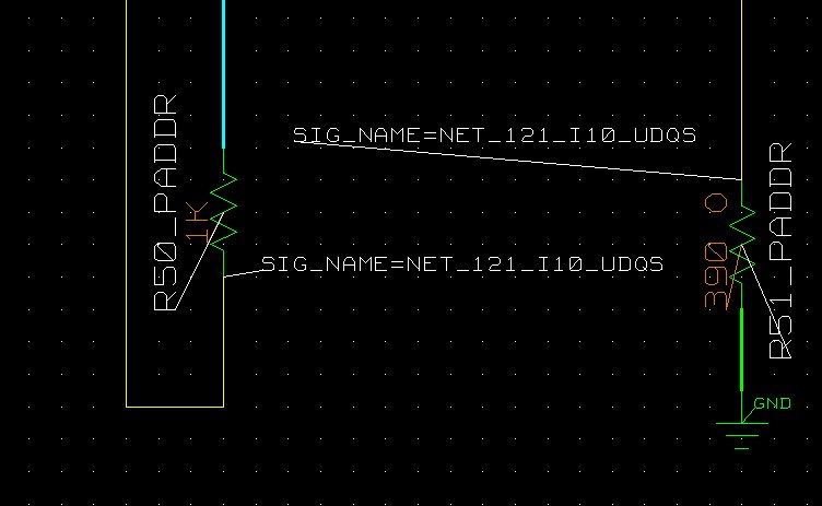

     Hi Bryn,
    I'll freely admit that I don't understand the exact mechanism for creating shorts like this. If my example of copying a component doesn't do it, that is good news. But the fact remains that I have a short in my schematic (and worse, on my prototype hardware) generated because Cadence has decided to attach sig_names to component pins.
     Please see the attached bitmap. It shows a short between two pins generated by the tool
    If a schematic has SIG_NAME properties attached to anything other than wires then it's associated netlist simply cannot be trusted.
    I still need to know, how can I remove these with a script, or even better, how do I turn this behaviour off?
    For info, I'm running 16.1p004.
     Best regards,
