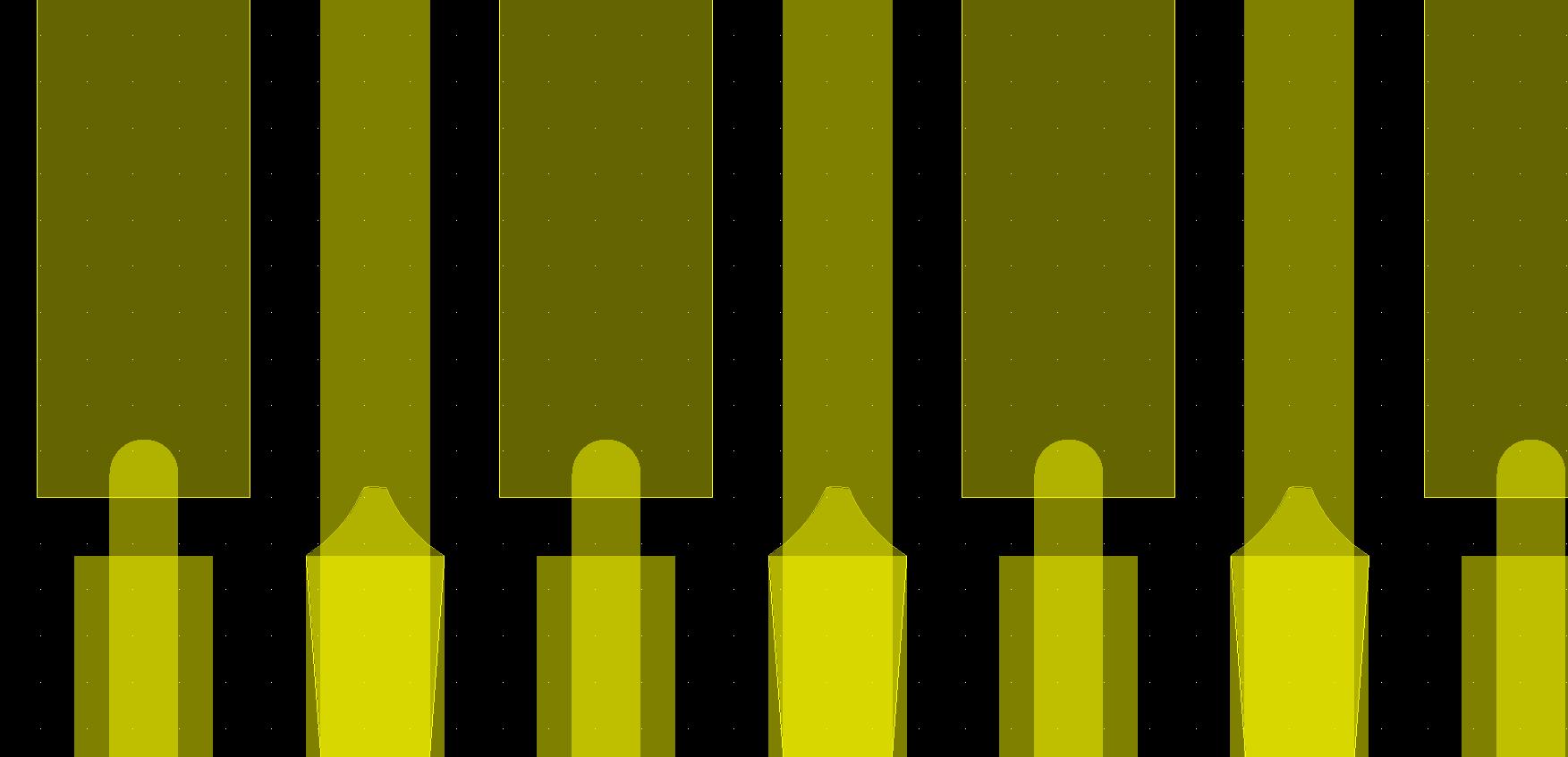

Hello!
I'm using Cadence Allegro PCB Performance Option L 16.2.
How can i make fillets at a termal relief contact? The fillets appear only between clines and pins if use the Gloss function. Does anyone know the setups to do this?
Thanks a lot!
Greets
  • steve
    steve over 16 years ago
    The setup fro Gloss is found under Route - Gloss - Parameters. For dynamic fillets look at Pad and T connection fillet button then Fillet Techniques for the angles, line widths and curved filets.
