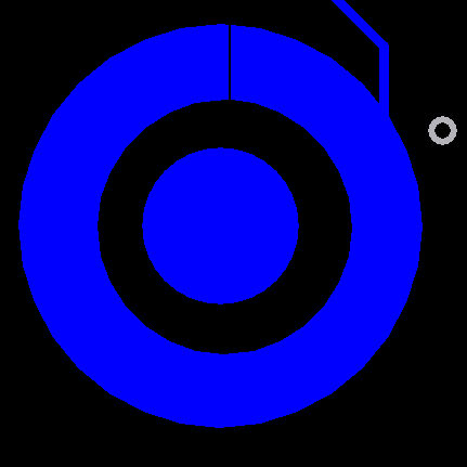

    You could create a pin using a shape for the top layer pad. Create a "Shape Symbol" and then you can use that as a pad when designing your pad stack. I have attached an image of an example I have used.

    I ended up taking bennigan's advice and creating a custom shape for the pad and that's the only way I was able to get it to work.  The other ways the shape would never take on the net name and would cause a DRC and I couldn't figure out how to reassign it to the proper net.
