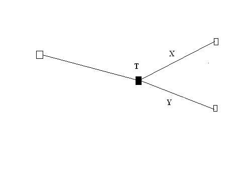

length(etch) matching from T point to pin....Allegro PCB-16.2
MAAC
MAAC over 15 years ago
Is their any option to set the constraints so that i can route the track such that length X= length Y(Refer the screenshot). The whole thing is a single track n the length has to be matched from T junction( T ) to two different pins i.e. through length X & length Y
Thnx

    Dennis Nagle over 15 years ago
    If it ruly is just matching lengths X & Y, then what you want is to use the Relative Prop Delay constraint in CM. Call out the specific pin pairs from the T-point to each load pin.
     but how can i specify the constraints from T junction to the pins. Rel prop delay takes complete track into consideration

    From Cadence Online solution 11041370 (http://support.cadence.com/wps/mypoc/cos?uri=deeplinkmin:ViewSolution;solutionNumber=11041370;searchHash=f08b9b215e4109b3d3f510e615d9067b)
    One way to accomplish this using Allegro PCB Editor is to extract the net into SigXplorer (SigXp) to create a topology file (Electrical CSet) with the specific pinpair constraints, update Constraint Manager (CM) with the new Electrical CSet (ECSet), and finally apply the new ECSet to other nets in CM. Applying the ECSet to the nets will automatically create the pinpairs.

  • MAAC
     To add few pts..i followed the same steps &
    • i named  MGT1as relative prop delay from T.1 to U15.11 & MGT2 for T.1 to U36.11
    • then updated to CM & again i created one more Match Group MG11 consisting of MGT1 & MGT2
    • mentioned the delta:tolerance::10mil:1% (10mils is the relative delay between MGT1 & MGT2)
    • then i could achieve the relative delay using the delay tune
    thnx everyone for the help
