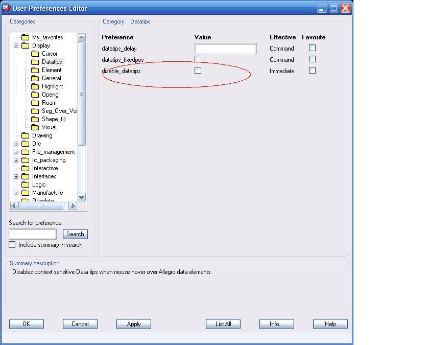

Can I disable the "hover over" in 16.2 ?
Ty Thomas
Ty Thomas over 15 years ago
I find it visually distracting when the routing is dense so I'd like to be able to turn it off. Any suggestions?
 Thanks -
  • redwire
    redwire over 15 years ago
     Yes.  It's in the User Preferenc->Display setup.  See attached image.
