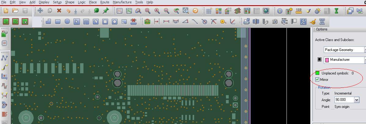

     There are some other ways to mirror while placing....
    In the options box, you can click on "Mirror" and all parts you place from that point will be mirrored....
    Or you can set up a preference in the Setup->Design Parameters
    I use the right mouse "mirror" command over all the other suggestions but each has its merits.
  • redwire
    redwire over 15 years ago
     Here's the "options" box view (click to see entire image)
