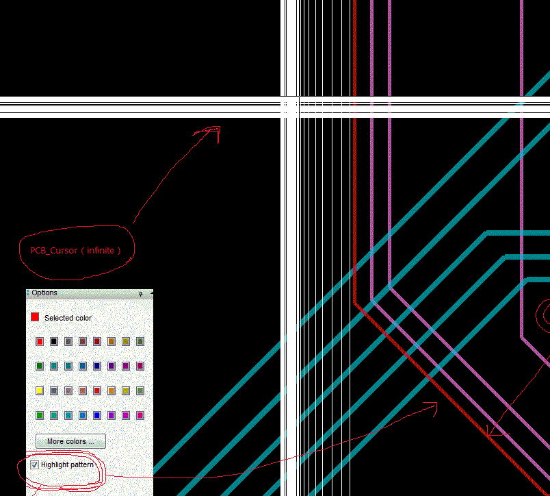

 allegro v16.3(v16.2)  OpenGL graphics (select)
 os (windeows 7)
 PCB_Cursor (infinite)   bug ???
 Highlight Pattern  bug ???

    Looks like the Highlight Pattern is still an open issue, this was due to be fixed in 16.3 but it looks like it didn't make the release.
    The infinite cursor issue was fixed but has an additional flag to set if the problem persists, at the command line, or in the env file have:
    set infinite_cursor_bug_nt
    Command line will be a temporary fix to check it out, the env file will get it set when the product is started.
