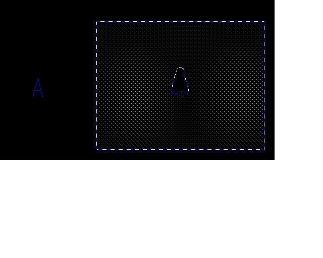

  • davidsun
    davidsun over 12 years ago
     HI Steve,
    I followed you instructions, and attached is what I get. it looks not correct to me, is there anything wrong?
    Sincerely
    David Sun
  • steve
    steve over 12 years ago
    You will need to void the centre part of the A first then do the outer part of the A, otherwise you wil only get the outer shape of the A (which is what you have.
