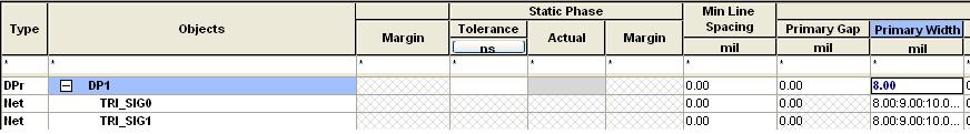

Different width_DP_different layer
MAAC
MAAC over 15 years ago
I have req. where in i need to set the constraints with width for the nets for differential pairs for different layer...I am able to do this for a normal net routing..but for dp while i route the width the router takes is of primary width from CM...which can be defined with only 1 set of values which will be same through out for different layers...How can i set these constrainst?
  • MAAC
    i got it....assign the PCS created in Physical to DP which is under Physcial-Net-All layers....
