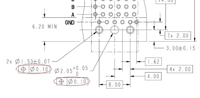

 Dear All,
    What's the meaning of the text which is in the red circled area in the snapshot? The hole drill size's are 1.53 and 2.05 diameter. But what's the 0.10?
Thanks and Regards,
Shiva.

    Shiva
    Dave is correct, it is a symbol for geometric tolerancing for the hole position. Have a look at http://en.wikipedia.org/wiki/Geometric_dimensioning_and_tolerancing which describes this symbol plus others.
