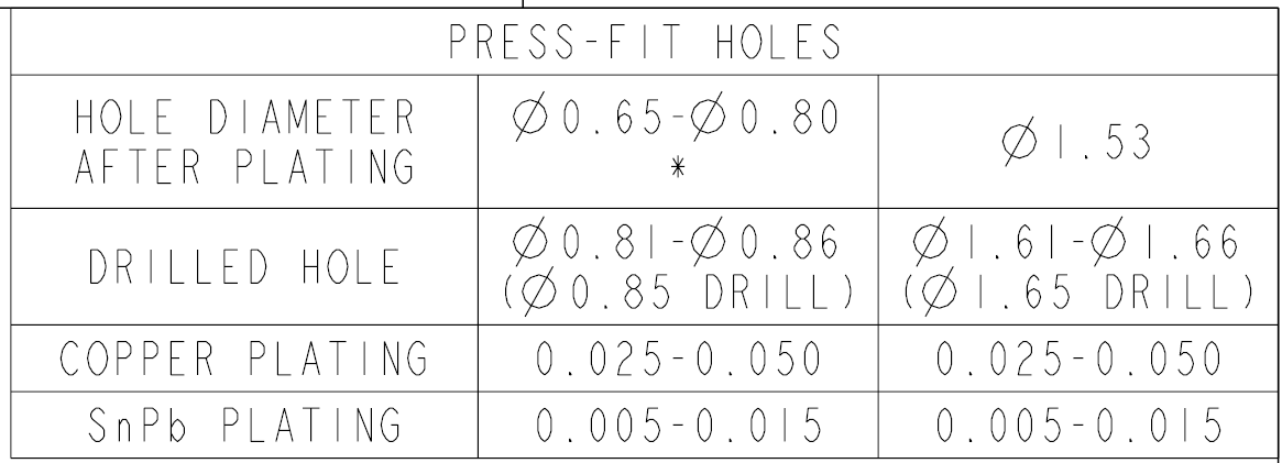

Whatever we are mentioning the drill diameter in the pad designer is driled diameter or finished diameter(after plating).
I got confusion while creating padstack for pressfit hole(shown below) which drill  value to be entered in pad designer ?
Any one please clarify..
REgards,
Girish Kumar

    Mashak over 15 years ago
     Hi Girish,
     It is always the Finished hole Diameter that you specify in Padstack creation and with comes on the drill table..
    Mashak
