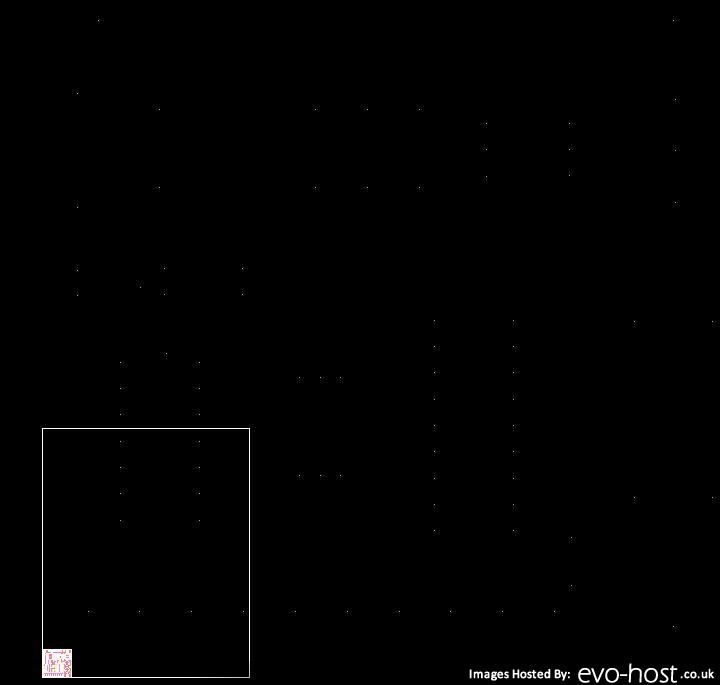

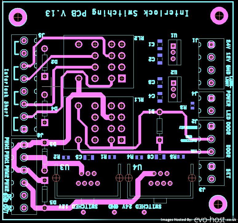

 Im having problems with the output .drl files after finishing some of my pcb designs in PCB editor and am hoping someone can help.
 So basically, after creating my drill files with some pcb designs ive noticed that when viewing the gerbers to check that everything is ok (using GC-prevue) that the drill holes look overscaled, and are therefore in completely the wrong place. Ive attached two screeners to compare a correctly mapped drill file with an overscaled one...
 Correctly drilled
 Incorrectly drilled
My NC drill preferences are exactly the same for both of the above designs, and everything in the design preferences is the same (everything set up in metric), but i seem to be getting different results.
Can anyone help?
  • Cujo
    Cujo over 14 years ago
    Hi, in the NC Drill Dialog Box select Auto tool select and Repeat codes.
    In the NC Paremeters Dialog Box select Enhanced Excellon format
    Regards
  • gtaylor
    gtaylor over 14 years ago
     Brilliant, it worked. Thanks so much!!
