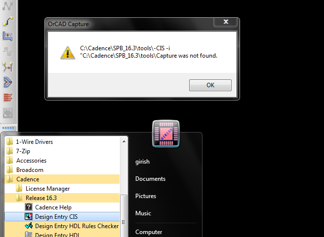

I am using Windows7 32bit OS.Orcad Capture CIS & Orcad PCB editior was working fine.
But when I updated hotfix ( “ Hotfix_SPB16.30.018_wint_1of1”) Oracd capture not opening it is showing the attached error.
any one faced this problem?

    oscar migs over 15 years ago
    I have seen this problem in hotfix 18, but only when I select Orcad instead of Allegro Design Entry XL
    Best thing to do is modify the shortcut.
     Set the following
    target:  C:\Cadence\SPB_16.3\tools\capture\capture.exe
    start in:  C:\Cadence\SPB_16.2\tools\capture
    Best,
    -oscar
