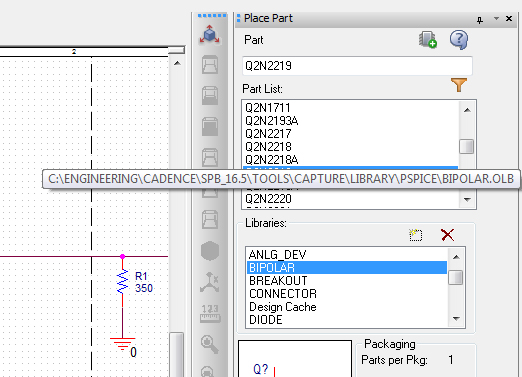

Getting rid of the library/part path tool tip
xrwright
xrwright over 13 years ago
Is there a way to get rid of the pop up tool tip that shows the full library path when I place my cursor over either a listed library or a listed part in the Place Part dialog? I find this pop up extremely anoying and I've looked at all the options and customizations I can find to get rid of it with no luck. Thanks.

    oldmouldy over 13 years ago
    You would need to raise an enhancement request with Cadence support to get this investigated since, AFAIK, it's not possible to configure this at present.

    hmkr over 13 years ago
    You can do this using the TCL command in Capture TCL shell-
     PlacePartToolTip 0
  • xrwright
    That does it. Thanks!

  • xrwright
    Thanks hmkr,
     It seems that all I needed to do was call the command once and now the command is autoloaded each time Capture is opened.
