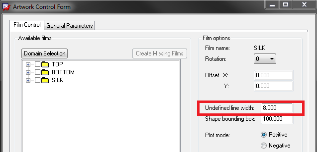

  • mcatramb91
    mcatramb91 over 12 years ago
    It sounds like you have the Undefined line width set to 0 in your Silkscreen Film Record.  You will need to give it a number greater than 0 for any features which don't have a line width defined to show up in the Gerbers.   For example, if you have silkscreen which is drawn with rectangles they will not show up in the Gerbers unless you set the Undefined line width on the Film Record. The same would go for other elements that don't have a line width defined, they will no show up in the Gerbers files.
    You don't need to set the Photoplot Width for each of your text blocks unless you require a different line width compared to the Undefined line width in the Film Record.
    Hope this helps,
    Mike Catrambone
